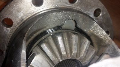

Just did mine 2 months ago. Synthetic 75-140(its on the tag), just under 3 quarts(warning about $12/qt). It was not a posi/locker, just an open diff. It did not need the modifier. A positraction, will have a large assembly between the ring gear and axles. The fill plug was very difficult to remove. Good Luck.
