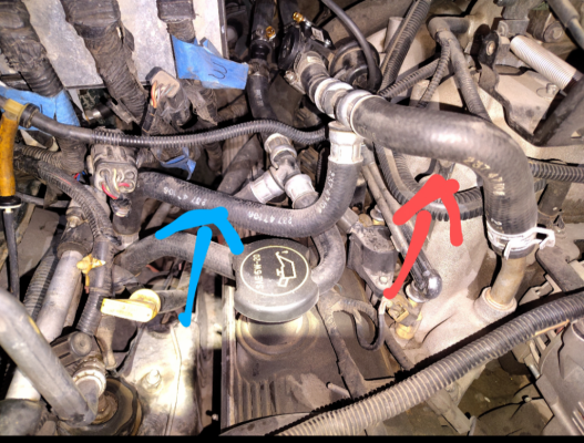

I can't really install it on the line to control both of lines at once because of the way the hose bends (red arrow) so I'm having to opt adding a second one in at where the blue arrow points (that hose goes to the rear heater core input. The hose under that one is the return).
I'll simply also add in a vacuum line tee and splice to that to control the new valve.

How 'bout just putting a stainless ball valve there in that line where your blue arrow is ? You'll probably never open it, but if you need to you can.
That way no extra vacuum plumbing is needed and it looks clean. Maybe you're on to something? Let us know how it works out.

The simple ball valve might've been an option but I had already ordered another heater valve (Motorcraft YG368 Heater Valve) for slightly under $21 from Amazon.
I already had hose clamps and vacuum line tees handy.
The whole job took under 10 minutes to do and I didn't even spill a drop of coolant because I placed a small Tupperware bowl under the hose before I cut it.
I *was* worried that maybe the available vacuum wouldn't be enough to close both valves, but they work perfectly.
