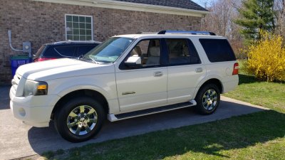

I am a new proud owner of a 2008 Expedition Limited as of two days ago. It was missing some so I had the code pulled which came back po358. I replaced all of the coils and plugs today and after getting everything put back together and the battery connected I took it for a test drive. Cel came back on and it was still missing. Do I have to wait for the drive cycle to complete before the computer acknowledges the new parts? 20190322_151429.jpg

Pretty truck, by the way. My 08's white too.
