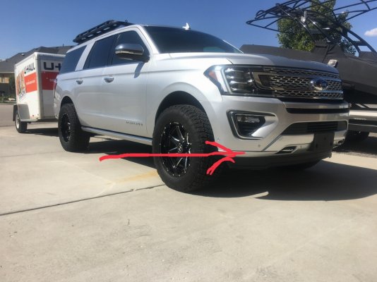

Saw a post on the forum some one had removed the front air dam and I think it makes the expy look nicer. Any reason to keep it on? I am sure it's there for aerodynamics but when your driving an almost 3 ton vehicle is it going to make that big a difference?

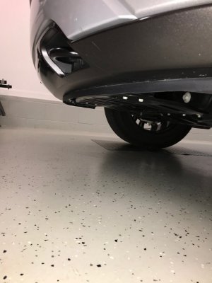

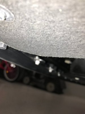

I removed mine and it looks so much better. I used the 4 self tappers you take out and used the factory holes and screwed them into the carpet wheel well to help hold the front tighter. I removed a bunch of plastic and carpet to clear my 35’s so I did really care about screwing new holes.

I taped the back side with painters tape and marked the cutting line and used my Fein oscillating tool with a half circle fine toothed blade.
Thanks... When my skids plates arrive I will be doing this as well!

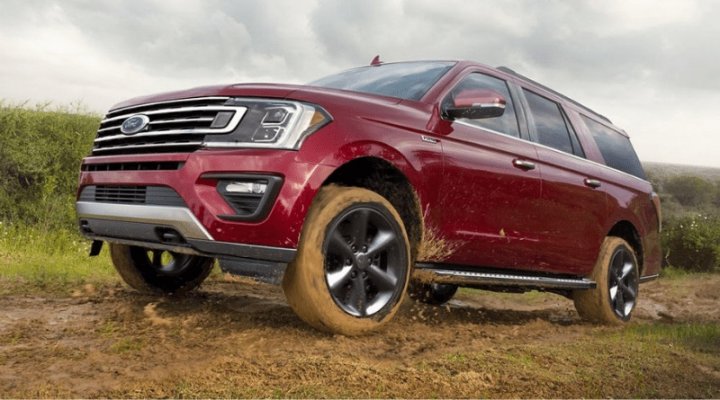

I need to look at an FX4. I have yet to see one in real life, but a lot of pictures show a different air damn That is short in the middle. Plus when you add the skid plate the low pressure area would be gone or moved way back. I would think.

Correct. The FX4 has a shorter air dam as stock. Those of us that have added skid plates to non-FX4 models have either removed the air dam completely, or trimmed it in some way based on personal preference.

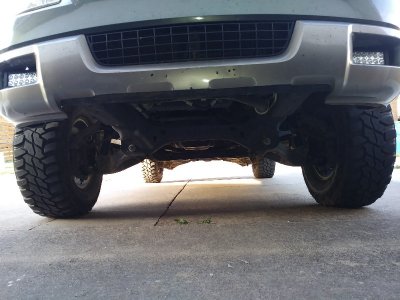

Removed mine AND trimmed beyond that to give me a higher angle of approach. I'm clearing 12.5 inches at the lowest point of the undercarriage.
Also trimmed the rear for a better departure angle and to mount backup LED bars at the outside edges of the hitch.

That doesn’t look like a Gen 4, but I have been thinking about cutting the next level up off. Anyone done it?

Fozzy, that's a nice looking rig. What roof rack is that and how does it mount? I haven't found one I like yet, but I keep looking...

It’s a Rhino Rack Pioneer Platform. I have the side rails on it for now. It’s mounted to the stock crossbars. There is a little movement and flex. I may upgrade to the heavy duty Rhino bars or buy 2 more Ford ones and use four bars and see how it does.
