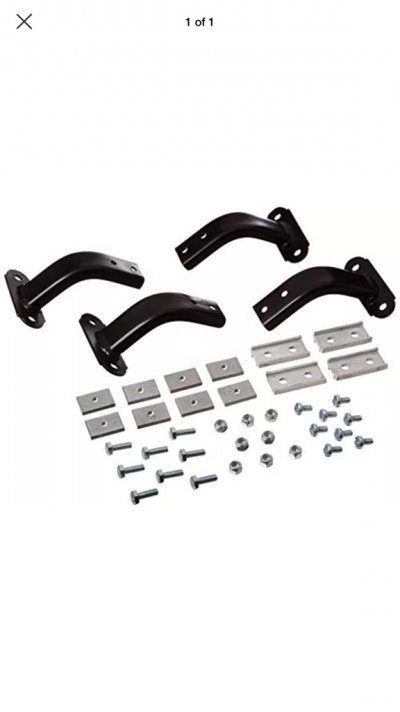

Correction 2 sets of mounts, each set brings 4
Waldo,
Do the feet that mount the rack have adjustments. Seeing as the edges of the rack are @ 50" and the roof rails sit in farther then the edges?

The cross bars are 60" wide and the mounts can be put anywhere on them.

No the crossbars on the roof rack are 60" and the rack mount on them. The ford mounts for the roof rack mount to the factory rails and then to those crossbars.

Oh I gotcha ok. Do you absolutely need the secondary cross bars for it to work?

I still haven't mounted it but those bars are way stronger than the factory ones. And since the rack is 84" long it brings 4 vs 2
