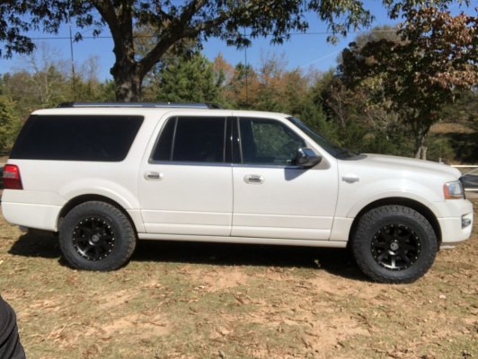

Other pricier option is Icon coilovers and UCAs. Pricey but the quality and capability is great. Also adjustable ride height (adjustable springs) and on the fly adjustable dampening (I believe 6 knob settings). I’ve got this setup w 34s on the wife’s 2015 Expy. Kept icons factory ride height setting on the shocks but will likely go up about an inch more. IMG_8996.jpeg

This is the first person I've seen actually running Icon on a 3rd gen! I'd love to hear more details. Also what rear shocks did you have originally? I have an EL with the nivomats in the rear and I don't know what to do

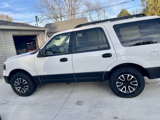

this looks like mine except mine has 2018 ford F150 wheels
