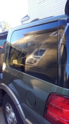

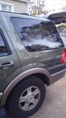

thanks for the followup. yes, i figured you wanted to save ca$h. always goodOver the weekend I went window shopping at the local Salvage yards, bought the window from one, it will be Tues. or Wed. to get it out of the truck. I'll let you know how that went Thurs. or Fri.

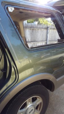

Yes ... something like thisGet a nylon tool (spoon). Usually comes in a kit for removing clips, plugs, etc. Won't scrape the paint off the metal. Screw drivers are not for this purpose. Amazon or local Walmart or parts store. Usually very inexpensive

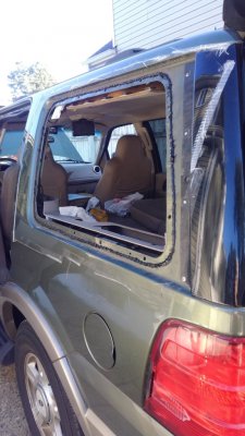

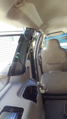

OK, today (Wed.) I picked up the window. The Salvage Yard (T&E Auto Wreckers, Avenel, NJ) took out the whole window, frame and tossed in the motor as well. The close up is what failed on the vehicle, the two glue spots just stop gripping the window. Now this weekend I'll have to start removing the plastic trim around the window and get the old frame out. Any advice on the clips, I usually try to work the trim piece with a small screwdriver but perhaps there is a better way or tool to use..???
