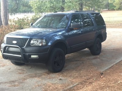

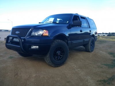

Man oh man I have never been so happy to complete a project in my life. After about a days worth of work she is finally done. I'm no mechanic but I got it done. Lots of trial and error but im loving the way it sits.

Glad you got it done ok. It's just your time you spent. Now you can be proud of your work and tell your friends I did this job!
