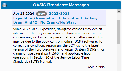

Ford is reinforcing this message to Service personnel as Special Service Message 52445...
SSM 52445 - 2022-2023 Expedition/Navigator - Intermittent Battery Drain And/Or No Crank/No Start
Some 2022-2023 Expedition/Navigator vehicles may exhibit intermittent battery drain or no crank/no start concern. The concern may no longer be present after a battery reset. This may be due to the body control module (BCM) software. To correct the condition, reprogram the BCM using the latest version of the Ford Diagnosis and Repair System (FDRS). For claiming, use causal part 15604 and applicable labor operations in Section 10 of the Service Labor Time Standards (SLTS) Manual.
Below is a screen-print of this newest message, as presented on Ford's Professional Technician System (PTS) website, just in case your dealership's Service Department is unaware of this message or otherwise challenges this information...
