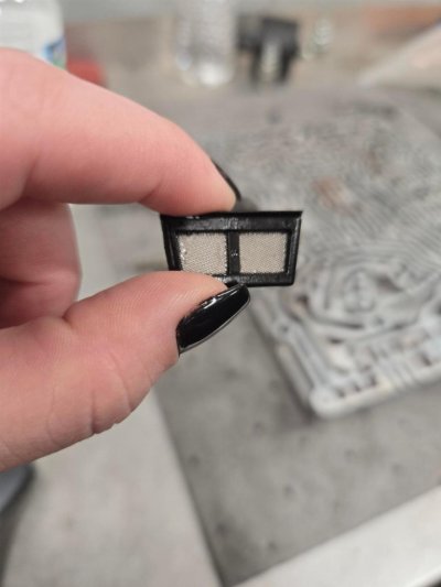

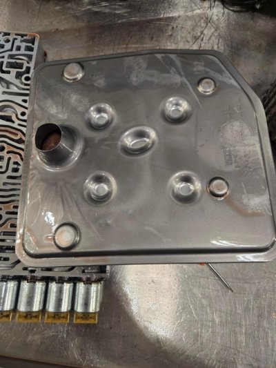

Well, its about as bad a diagnosis as I was not hoping for.
"The technician says it looks like there is internal damage to the one way clutch. He found metal chunks in the valve body, some of the valves would bind up and the filter tip looked damaged as well. The tech does suspect there could be more internal damage than what we noticed on the valve body. He is recommending replacing the transmission rather than rebuilding it due to how labor intensive it is to rebuild and it would be less expensive."

The tech said he wondered if the fluid was overfilled but could that have caused this? I can't imagine someone at my shop saying, "Hey, let's putt LOTS of fluid in here even though it keeps coming out the input area before we can screw the cap back on" but again, I'm no expert on these things.
The tech said "it looks like there is internal damage to the one way clutch. He found metal chunks in the valve body, some of the valves would bind up and the filter tip looked damaged as well. The tech does suspect there could be more internal damage than what we noticed on the valve body."
So, perhaps the clutch failed or was loose or something internal just started throwing metal bits?

It would be very difficult to overfill, due to the location of the fill / dipstick hole. The only thing I could think of was either it was under-filled or improper transmission fluid was used. It's also possible that the replacement filter was somehow improperly installed (pickup tube clearance, seal damaged, etc).
If none of those are the case then it's just very bad luck. Normally these transmissions are very durable. Glad your discount helps out!
