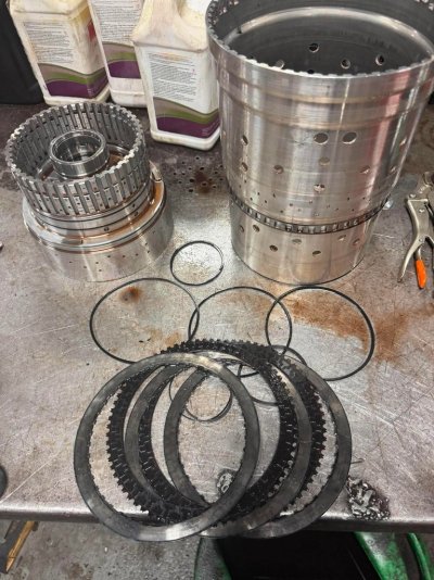

She is getting rebuilt with all the latest updated parts.
CDF
ANODIZED SHELL
VALVE BODY
TORQUE CONVERTER
I did not trust an off the shelf built unit as it may have older parts.
This way I know it has all the latest and greatest.
I have my doubts if it will last reguardless.
