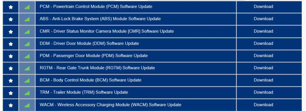

I got your message, but I am responding to you here because I cannot attach pictures in messages on this forum. It seems like your truck is affected by the SSM I posted above. Even though your Sync version is outdated, you do not show any pending updates for the Sync related modules. The dealer cannot help; the issue on on Ford's side. With the exception of the WACM, the other module in the list below can be updated via the OTA process, but Ford needs to release more updates for your VIN in order for you to be able to progress further along the OTA process.

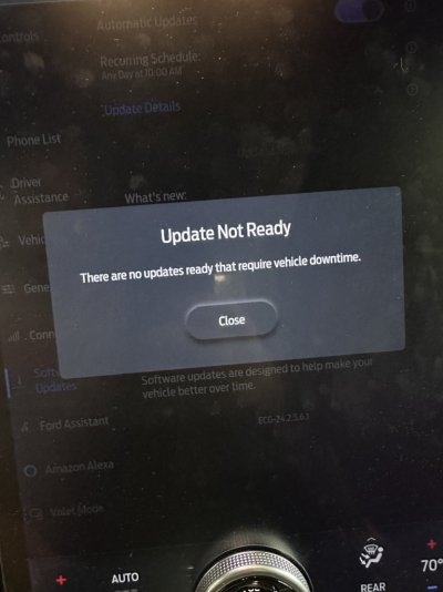

I know this is an old post but anyway you can check mine?
My FDRS license expired and I didn't renew it so I cannot check for pending updates. I still have limited PTS access. I can see you have been sent a GWM update several times, and every time, the OTA trigger expired because your truck didn't ping back the server to accept it. You actually have an active OTA trigger on the server for the GWM right now, but the same thing is happening. It also shows that auto-updates is not turned on even though you say it is.
When you check for updates, does the screen get hung up saying checking for updates with the pinwheel spinning, or does it actually check for updates?

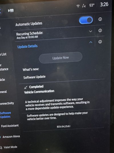

Here is my screen. I am on WiFi in the driveway . The update button is always greyed out. Not sure if I’m doing something wrong. I’ve set a time and also unset the time and still the same . Bought the vehicle in November of 2024 and never had an update.
I would try disconnecting the negative cable from your 12v battery for 20 minutes and then checking for updates again.
I checked again and the OTA that was in queue went from an active OTA to part of OTA history. Seems like it timed out again. I would still do the 20 minute battery pull and hopefully it goes through the next time they send it. See if the update now button is no longer grayed out after the battery disconnect.

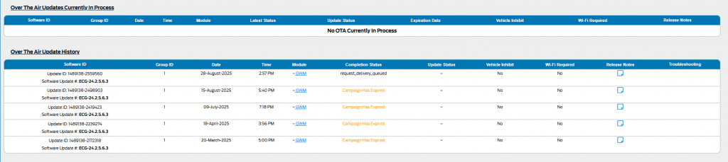

Ok so did the negative pull from battery. Hooked back up and started vehicle. And still greyed out. Connected to WiFi at the home in driveway. Guess we will wait and see. The only other thing I can maybe think of is where I live cell service is bad and typically requires a WiFi signal at my home. Do we think maybe the signal to the vehicle is being compromised too? When I use my app I can still remote start and all that so idk.
Your truck is reporting itself to the cloud regularly, so I don't think the reception is bad enough to blame it on that. However, now that there is no active OTA trigger in queue, the button being grayed out is normal because there is no update pending to install. However, the fact that it was gray when you DID have a pending OTA in queue was not normal.
I agree.....at this point, it is wait-and-see for them to resend it to see if it goes through this time. It is not normal for the same OTA to fail 5 times over the course of 6 months. If it fails again, the dealer may have to install that problematic GWM update so the truck gets past it and opens the door for the next update you are due.
