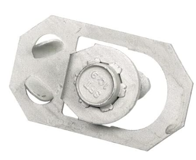

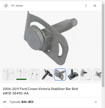

Thank you for saying retaining clip. That gave me a better search term. I found them for everyone's reference and so I could see an original one. Yes, mine are completely shot. I no longer have the ring surrounding the base of the head. All 4 have a half ring- half rusted away. So they are useless.
Now the punch line. The retainer clips, no matter where you look, are an average of $50...EACH! So in doing my rear suspension shock/struts, sway bar links, sway bar bushings for $300 in parts, 4 clips would bring it $500. Nope. I know Ford thought "Oh trust us, you'll get so frustrated that you'll buy them eventually"
I like your idea of grinding flat spots and was thinking along the same lines. Something to grab on to. Alternatively, I'm trying to think of a way to make just under the head bigger so when you put it in the slot of the frame opening it can't turn.
For people with the $ here is the part #. Include the dashes:

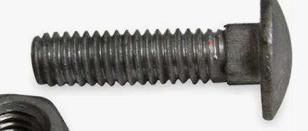

3/8" x 1 1/2 carriage bolt with a 5/16" washer on outer frame should do the trick. Just grabbed a handful and the key shaped slot on the frame "should" allow enough space to fit the carriage bolt head. Worst case is minor grinding. Then below the head is square and very very close to the width of the slot in the frame. So it won't turn. Will it when I push upwardsm and the square part is too high? Of course. So just use vise grips to pull down a bit. Should work fine. In theory.1000001142.jpg

Easy solution that is about 99% flush. 3/8" x 1 1/2" round head carriage bolts. The head does fit through and the square just below the head locks into the notch so it won't turn. It's really only the driver's side you can't push down from above so turn slow and gentle or vise grips again for that last bit. 2 days later for one hour of work on links and bar bushings. Done.

Just got thru having to remove/reinstall mine to replace fuel pump. I found one of these broken. Ford stealership said no longer available. I put in a 3/8 carriage bolt. Fit very well in the existing squared slot. Do wish I had grade 8 instead of grade 5 zinc plated. I did use a nyloc bolt. I did use one of the larger hooked picks to keep the bolt in the slot until the bracket got closer to the frame. After that the bracket was all that was required to keep the bolt in the slot and keep it from spinning.
