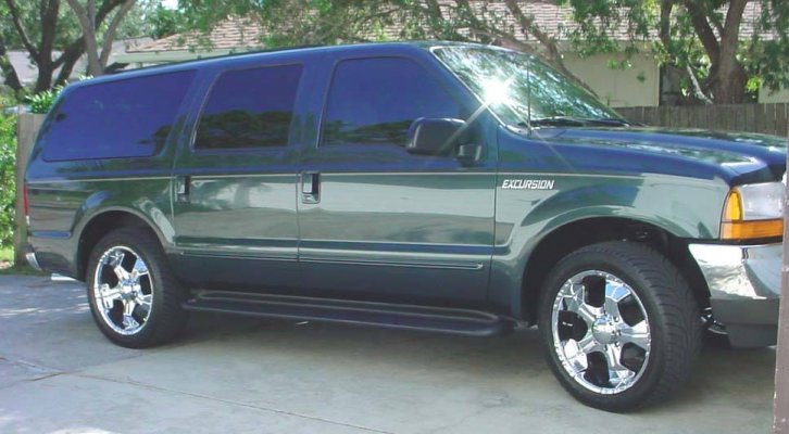

As far as engines lasting, it all depends on how hard you drive it and how well you maintain it. My 2000 Ford Excursion had over 200,000 miles on it. I mostly used it for daily driving and road trips and I occasionally towed a trailer full of gear. I kept it well maintained and it still looked almost new when I sold it 22 years later. I never tuned it. It was a stock 5.4ltr V8.2000-ford-excursion-xlt.jpg
