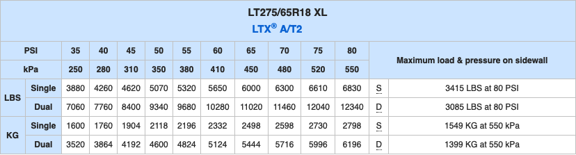

With my LTX AT/2 load range E tires I looked at the tire capacity chart from Michelin and picked the lowest pressure that supports the vehicle weight (including payload). When towing I put them up to 55 psi. BTW the load ratings below are per axle, not per tire.
I can no longer seem to find that chart on the Michelin website unfortunately. Hopefully your tires have a similar chart somewhere...

tire pressures are dependent on tire size and load, different brand/model tires all specify he same pressures at the same size and load. An "E" tire can handle a higher pressure than a "D" tire, but at the same load, it would use the same pressure.
sadly, all the tire makers stopped publishing those tables to the public. probably a liability thing.
my 2019 Ex. Limited w/ 22's says the front GAWR is 3375 lbs (1688 per tire), and the rear GAWR is 4380 lbs (2190 per tire). So with that 275/65R18, you should be able to run less than 35 psi front and around 40 PSI rear. (near as I can tell, the numbers on that table are per axle not per tire)
