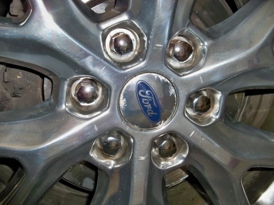

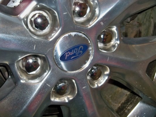

So I dropped my Expedition off at the dealership for "The Works", oil change, tire rotation, etc. When I got home I cleaned it up and noticed 3 out of 4 of the rims have these scratches between the lug nuts. These were certainly not there prior to the rotation. Just wondering what they used that would have caused that scratch pattern on the wheels. I'll be calling later today but I'm sure they are gonna try and blow it off. This dealership has serviced this car since new, hopefully they'll own up.

The employee may have “dropped” the wheel from its mounting location on the vehicle, allowing the tire to bounce and then it fell flat on the concrete floor (outside facing portion of wheel), scratching the face of the wheel.
Or - the circular scratches may have been caused by car wash damage?
The center cap has wear marks too. I have a 2015 Expedition Limited, purchased new, and the center caps still look new.

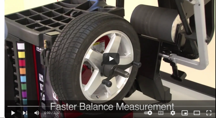

It appears they balanced the tires and when doing so the wheel is clamped into the machine on a tapered mandrel and a huge wing nut is tightened onto the center rim. That is likely what caused the scratches. 1706916919636.png

Looks like balancing augur marks. It does not look like a typical wheel dolly mistake to me, but it could be. Wheel dolly, the wheel sits in two crossbar rollers usually, with a dolly platform below it. But some use a stabilizer vertical that could scratch a wheel. Your marks look perfectly symmetrical in exact alignment with the lugnut centers, e.g. with the lugs. That is typically from use of a balancer, where the augur was too loose, so the wheel slipped in the "vice" of the augur, and the augur plate happened to be lined up with your lugs.
The machine is supposed to have a hard rubber "cover" on the augur, but those wear out, or it takes longer to use it, to avoid scratches.
Really is gorillas a lot times. Pictures before and after to protect yourself. Making a stink before works about 75% of the time, but not always. (Word doesn't filter down, and the worker doesn't care.) Wheel rotations and balance is the lowest guy on the totem pole.
