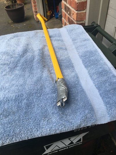

I replaced all three lines, the main lines connecting the transmission came connected together by the valve block, I undid them from the block to place them then re-fastened the valve block.
The connection at the engine coolant radiator between the radiator and the line coming from the transmission was sticky and required extra force to release with the Lisle tool, fingers alone weren’t enough so I fashioned this, using the ring of the box end wrench to press the Lisle tool in to release the connection - IMG_6341.jpeg
It may look like overkill, but I needed it.

*The Lisle tools are clamshell. I cut the old line so there was only a stub of line connected to the coupler into the engine radiator, the ring of the box wrench fit over the stub.
