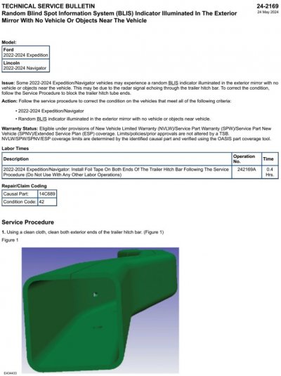

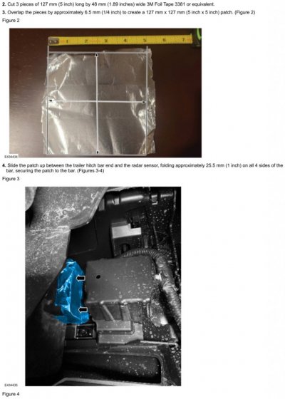

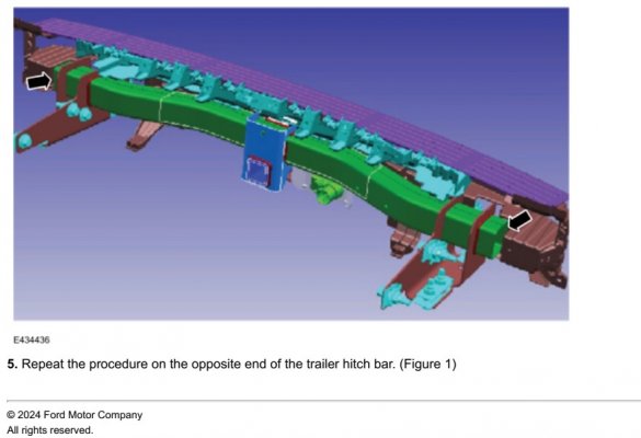

In this TSB 24-2169, Ford is providing an alternate Service Procedure to past-released TSB 24-2028, toward addressing random Blind Spot Information System (BLIS) warnings with no vehicle or objects near the vehicle, possibly caused by the radar signal echoing through the trailer hitch bar...
TSB 24-2169 is attached below as a PDF document...
