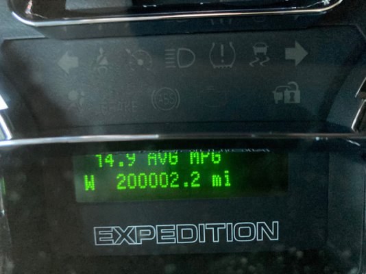

Nothing done to her today, but I did pick up a cabinet and rolled over 200k.

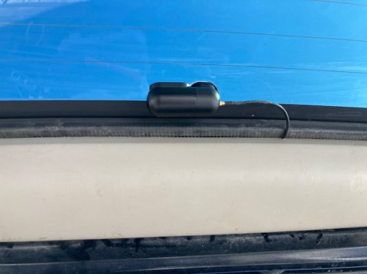

Finished install of my 3-cam dashcam setup. Routing the wire was much easier than anticipated with the exception of the rubber boot at the tailgate, which was a bit of a PITA.

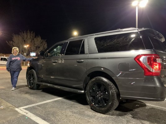

Spent V-Day at the dealership and then a romantic dinner in the Chick-Fil-A parking lot. But I think she likes it... She was at the tint shop at 9AM Tuesday making sure the front windows match.image_6487327 (2).JPGimage_6487327 (1).JPGimage_50411265.JPG
