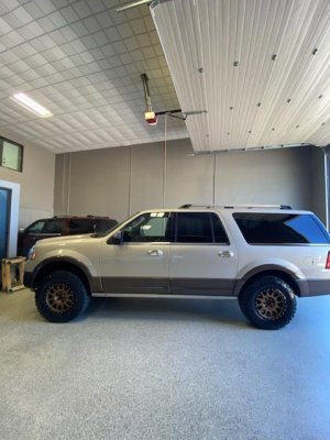

[mention]Fozzy [/mention] they r weather tech mud flaps. I’ll do spacers as well; maybe 1” front and 1.25” rear if I stay on stock wheels.

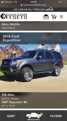

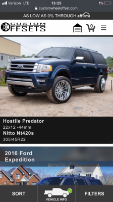

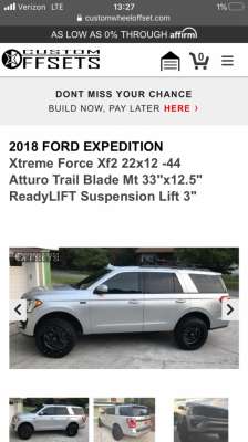

May go up to -19 if I do custom setup on American Force wheels or Forgiato.

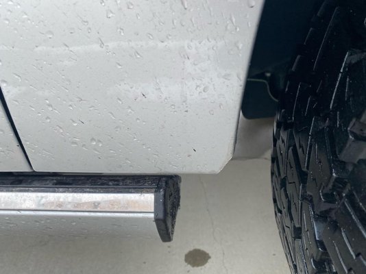

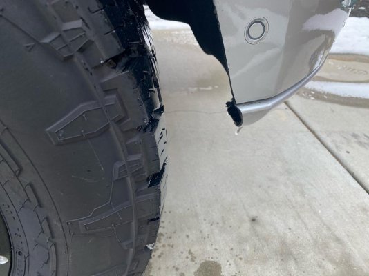

I hope -19 is a typo. They would hit for sure. I cut a lot for +12s. I may need to order a set of the flaps and see if I can mod them. I also cut my steps for the +12’s.
