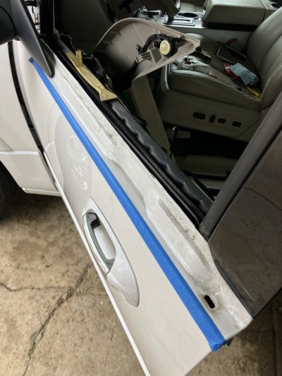

Drivers door- remove door panel, remove/loosen mirror. Carefully pull up on trim to release the one clip near door opening. Picture 4. Friction is only thing holding trim on, helped to use wood shim and tap shim upward. Disconnect wiring to control key pad, on inside under mirror mount.
