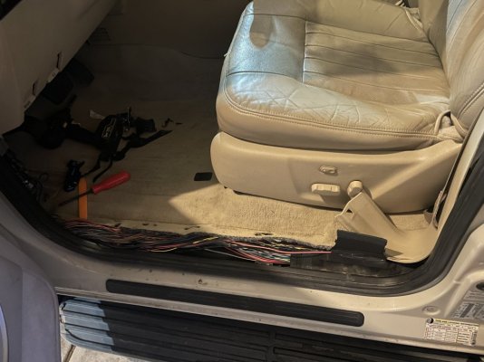

Thanks for the input guys, @blacktail I pulled up all the wiring as seen in the attached picture on driver and pass side are you saying there is more that run below that in actual rocker panels?
@whtbronco, I believe you are correct the bcm is located within the fuse panel at the top. When digging around in all the wiring and checking fuses it all looked brand new but I will pull out those connectors and check. As you stated water has to be getting in somewhere I just haven’t where yet.

You're picture has the wires that I am aware of that are in or near the rocker panel. There's no wires on my passenger side rocker panel of that I am sure, the big hole I made tearing out the rust allows me to see it, :-(.
