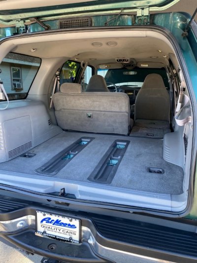

My first step was to remove the third row seat. I am married with no kids, so having this many seats does me no good and I can't sleep in the back with it in. :)

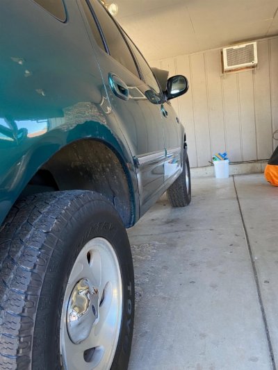

Next I removed the running boards. This was a lot more annoying than I expected as there were around 30 bolts total, but pretty easy. Free ground clearance!

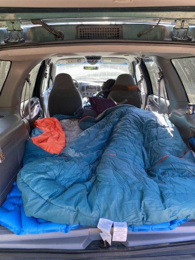

We slept in the back of the truck after unloading all our crap. With an inflatable sleeping pad it was alright, not great, not terrible. I think in the future I'm going to cut a piece of plywood to cover the third row attachment wells (not sure what to call them) in the back. Also might try to find some padding to throw back there.
