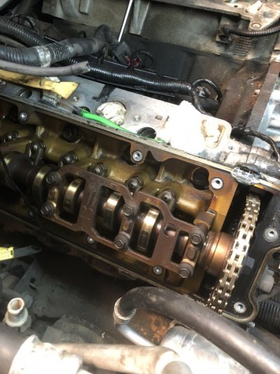

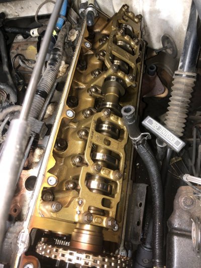

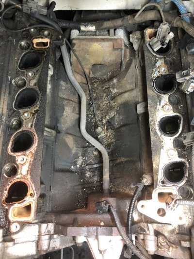

I’m down for a timing chain replacement, but find this on No.1 cylinder.. That explains the slight misfire.. I’m going to order a scope .. I guess the head gasket is gone.. Y’all look it over.. Maybe you guys see something I don’t..

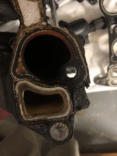

I determined it was just a intake leak, so I’m going to continue with timing chain update.. I’m not a pro, but I don’t mind a good fight.. Just hard getting around, lol

Yeah, probably just coolant from that intake gasket leaking between the water jacket and the intake port. It's not uncommon. Do you smell any exhaust gases in your coolant reservoir, or has it been blowing coolant out the cap from being overpressure ? Replace the two O-rings on that water pipe there under the intake before you re-assemble the motor. If you haven't already. Pull the crossover pipe off the intake manifold and inspect the mating surface for delamination and install new gaskets on the crossover. This will save you headaches down the road. Is it still the factory Ford intake? Or has someone replaced it with a Chinese Dorman ?
HVAC Coolant Pipe O-rings at Rock Auto
Fel Pro Intake Crossover Gasket Set at Rock Auto

Thanks for the reply, intake is the all metal, crossover is one piece with the manifold.. You are correct leaking manifold to the number one…. Should I stick with it? It is heavy lol
Anyway I was thinking head gasket, but found the water leak, on the line going to the rear heater..
I had thought it might be a head gasket.. I ordered a small inspection camera to have a look.. No1 was full of carbon gunk, due to the misfire.. All other cylinders look good..
Been taking a break on the project, but I thought I would look down the oil filler with the camera.. I wish I hadn’t done it.. Saw some shiny small pieces of metal.. Probably have a follower bearing going , but the engine wasn’t tapping excessive..
I got to get the harness off the engine.. Hard for me to get back there at that mounting point, then I can take the valve cover off to see what’s going on

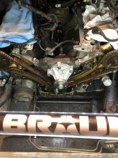

I have the heater return water pipe unbolted, but it must be rusted welded to those orings, and inlet.. Tried a little heat..
Do I have to cut it off?

Feel around back there for a second bolt. Might be hidden by the harness back there. But you should be able to just wiggle and pull that pipe off.

I did, but it’s welded on the nipple of the pump. I bent it a little trying to work back and forth.. I should have used another technique, like vice grips near the mount.. May have to cut it off with a dremel lol

Wow ! How 'bout a propane torch to heat it up a little ? Does it look like it's rusted on there or something ? Some penetrating oil ?

I used a heat gun, but will do the torch ..looks good on the outside, but just not moving one bit..I’ll get a new pipe after this lol
Next fight will be trying to reach the O2 sensor connection..We taking our time.. Thx for the comeback
