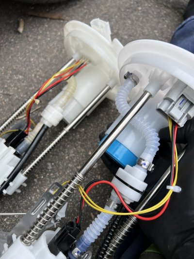

Ok, finally got around to redoing the timing. Looks like the previous owner used some cheap chinesium parts and put in new cam phasers. I think they didn’t change the timing chains and certainly didn’t change the tensioners and guides. One of the timing chains was stretched enough it ate the front cover alive. Besides being a total pain it was pretty straightforward. However it still doesn’t start. Cranks completely differently now way faster and sounds like videos of this motor cranking. Has spark and fuel and exhaust smelled badly of gas so possible I flooded it when I was cranking it with crank position sensor unplugged to prime the oil.IMG_3904.jpeg
