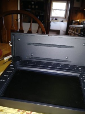

The reason I asked was because the navigation didnt work, Called out dirty disk error.
Well took it apart, it was not so hard and cleaned the Laser lens with rubber alcohol.
It works perfectly.

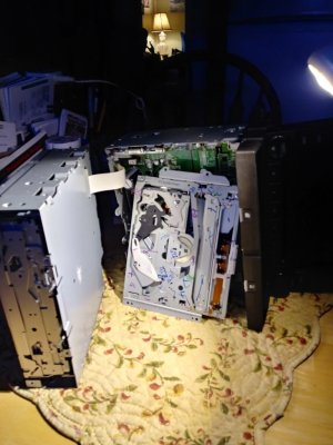

I had the unit open to access the 4 screws in the front when I unplugged it.
DVD Player is under the 6 disk CD unit.

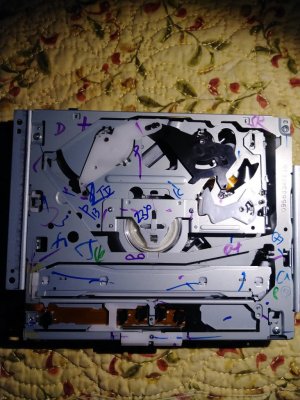

I unscrewed the 2 screw on the top in last picture that is part of what holds the disk.
Took that part out, then I could access the lens to clean. (damn didn't take picture of that)
