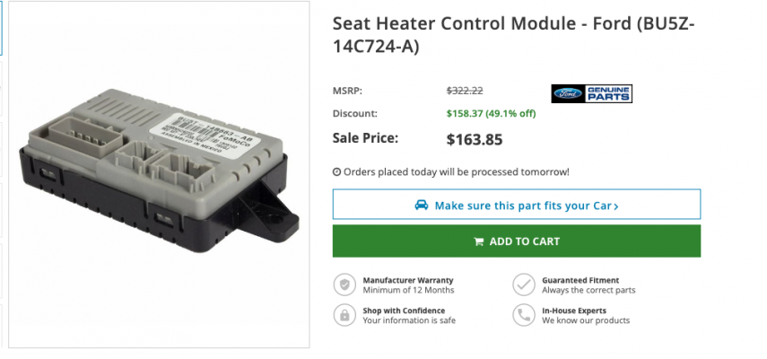

I would look at the heated/cool seat control module mounted underneath the passenger seat. I think there is one for both seats. I was having the same issues some years back and when I pulled the module, I noticed that the ground wire had melted on the wire harness that connects to the module. I did some splicing to the harness and it resolved the issue. Here's the module. Screen Shot 2023-01-05 at 3.52.18 PM.png

It could be the module, but more likely be one of the plug-in connectors under the seat.
Ford's are notorious for poor connector prongs.

It’s the module under the passenger seat as listed
Above. Probably need to get the pigtail for it too. The ground gets too hot and burns out. The new pigtail has a double ground.
