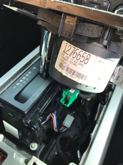

I know this is old, but for future searchers, my cup holder ambient lights weren't working when I bought my 2015 EL so I pulled the console and sure enough the plug wasn't even plugged in. Fixed that problem in literally 5 minutes. 06ab84f422a477b201bf3f78287dd030.jpg
