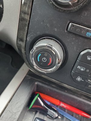

Replaced blower motor resistor, and connector. Blower runs high all the time, even when starting the vehicle. Swapped relay with known good (rear washer), checked fuse. Not sure what else too look at. Temperatures change from hot to cold.
Pulled blower motor relay in engine compartment, blower stops of course. The attached button (photo) does nothing except changes temp. I cannot adjust front fan up or down on or off on Sync either.
