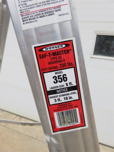

I've been using this ladder for years. According to some DIY website geniuses, I should be seriously injured or dead by now. Haven't weighed under 200 since high school and regularly sit on top of the silly thing. Safety first, I get it, but I'm not renting a scissor lift or setting up scaffolding to install a ceiling fan - sorry OSHA.
