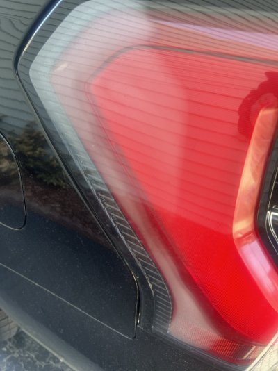

2019 limited with LED taillamp housing option (only has reverse halogen lamps)
Anyone ever have issue with the taillights housings showing condensation after rain? I guess I could just pop them out and apply silicone sealent on the "joints"
Is their a known area on the housing that lets the water in and what did you do to prevent the water intrusion successfully

Make sure there is a weap hole in the bottom of the housing. Should already be there. Make sure it is clean. It is normal to some degree, because they are not sealed. Is it condensation, or coming from a distinct location?

I updated my OP with pics. Both the driver side and passenger side has this condensation in the housing lens after it rains out or car gets washed. It goes away after a day or so of no water contact with the elements. I see no obvious "holes" on the housing .I still meed to remove the housing from suv to give a full inspection of the whole thing. Just wanted to seenif anyone else has thos issue and there is a common area of water intrusion

Based on those pictures, Ford, if warranty would call it "Normal" because no standing water, or large drops. Remember, these aren't any worse than housings from 10 years ago, there were just VERY hot bulbs in there to burn it off. They haven't gotten worse, just nothing to assist with the removal. Our 2020 does it every now and it is worse, cause I even installed LED backup lights! HaHa! These are NOT meant to be sealed. They have holes where water can get in. Best you can do is try to prevent large amounts of water from getting behind the housing, and make sure it is as sealed as possible where the wire and bulb holes are.

My passenger side fogs up after a car wash. Not much I can do to prevent it. but it dries out in a couple hours. I also swapped backup to LED, but it was doing it before the swap.
