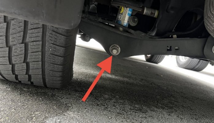

I picked up a 40" long 3/4" drive breaker bar at TSC for $29.99....one of the best tool buys I've ever made...have someone hold the steering wheel if possible while you use about 40 lbs force to break those caliper bracket bolts loose....It'll put a smile on your face....If you ever put rear shocks on....and have to torque the strut bolts to 408 ft lbs....add a 3/4" drive torque transducer for about $70 on Amazon and smile again.
408ft/lbs on any bolt on this chassis? Seriously? or is that a joke? You're in the neighborhood of grade 8 bolts to have the torsion resistance of 408ft/lbs and something tells me Ford doesn't want to invest in grade 5 let alone 8...
Yes, that's on the rear suspension. I changed out the rear shocks, and think I got close, but maybe not fully 400ftlbs.
