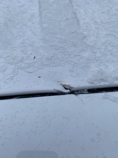

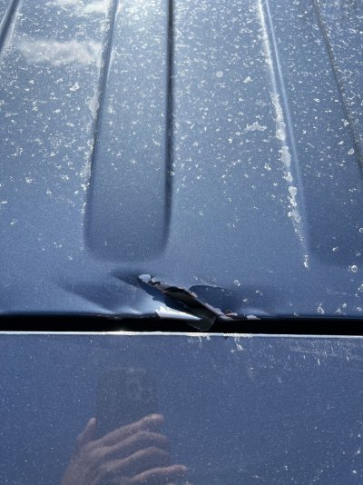

This is crazy. I had the exact thing happen to mine 2 days ago during the cold spell. Cracked plastic spoiler over the rear hatch and a puncture to the roof. We are taking it to the dealership tomorrow. I hope this is covered under warranty. Pics below.

that for sure looks like it was caused by ice.

To say this is a disappointment is an understatement. I can’t believe snow and ice would cause this type of damage. Sticking doors, etc., sure; but cracking plastic and punctures to sheet metal? No way.
My expectation is all windows and doors operate properly in all weather conditions.
I’ll be sure to update the thread on how the dealership/ford handles the situation tomorrow.
