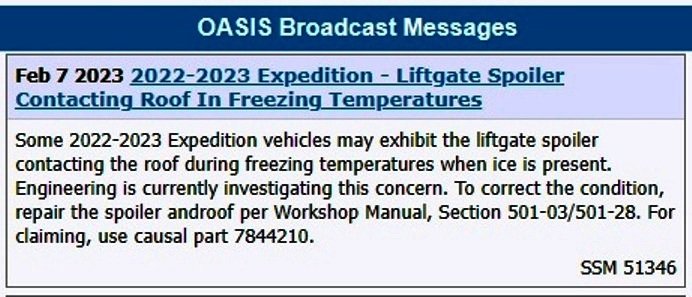

SSM 51346 - 2022-2023 Expedition - Liftgate Spoiler Contacting Roof In Freezing Temperatures - Released February 07, 2023
Some 2022-2023 Expedition vehicles may exhibit the liftgate spoiler contacting the roof during freezing temperatures when ice is present. Engineering is currently investigating this concern. To correct the condition, repair the spoiler and roof per Workshop Manual, Section 501-03/501-28. For claiming, use causal part 7844210.

***Updated service action***
SSM 51369 2022-2023 Expedition - Liftgate Spoiler Contacting Roof In Freezing Temperatures - Built On Or Before 26-Jan-2023
Some 2022-2023 Expedition vehicles (not including Expedition MAX) built on or before 26-Jan-2023 may exhibit the liftgate spoiler contacting the roof during freezing temperatures when ice is present. This may be due to an insufficient margin between the liftgate spoiler and the roof at the roof center line area. To correct the condition, repair the spoiler and roof per Workshop Manual, Section 501-03/501-28. Make sure that the margin between the liftgate spoiler and the roof is a minimum of 6.5 mm at the roof centerline after liftgate adjustment. For claiming, use causal part 7844210.

Thank you for the updated bulletin. We haven’t heard back from the dealership yet. I called over a week ago to make them aware of the SSM. Not sure what is going on…

I’m still waiting to hear from dealer. My mechanic/body shop guy said the Liftgate delaminated (the rubber piece).
Please update if anyone has had success since the “bulletin” came out.
lubbers6
Apr 3, 2023
indiana
The dealer is going to fix the Liftgate crack. Thanks to this forum!!! Thank you thank you!!!
