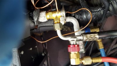

i did find the source of the LEAK other than the shrader valve. look at teh rubber o ring on the high pressure line where it connects to the tx valve
