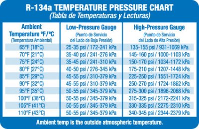

"IF" someone was to go by this chart found on the net, would these readings be taken at idle? Also, would they hold true for all R134A systems, including the dual air Expy's? Hopefully, i will never have the need....just curious.
