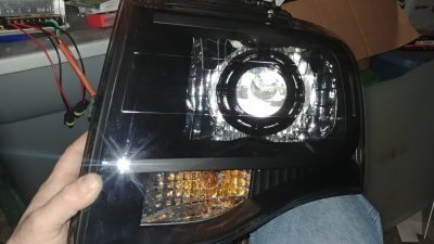

My current set is chrome reflector and shroud. The new shroud is black so I'm thinking I may paint the reflector also.

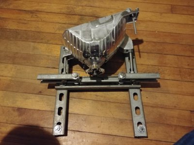

There's not really a lot that can be screwed up and this is more of an advanced mounting method than some of the others out there. Any projector with the threaded shaft would make it ten times easier but they don't always have the best output like these ones do. I may end up selling the reflectors with my threaded shaft projectors when I'm done. it wouldn't be the entire headlight just the inside reflector with projector and can pretty much be dropped in any 7/14 Expedition by just disassembling the headlight housing and aligned.

The H1mini, mini D2s and G5-R/EL/EXL are the best threaded shaft options available at the moment. All can be found through
Lightwerkz.net
There's really no other parts needed if you order a kit from lightwerkz with the exception of some JB Weld to lock things into place
