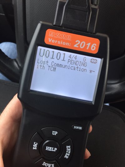

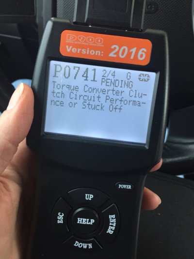

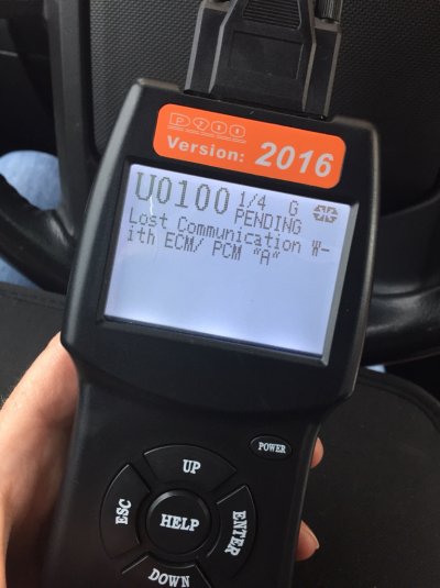

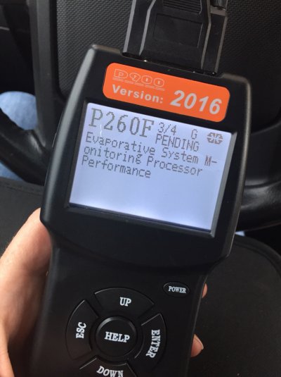

Ok so I took it in for the reflash 3 weeks ago. Since that time, I have had the same code, and now a new one. Calling ford tomorrow bec I feel like they may not have programmed it correctly? Can someone tell me what this now means please?
P260f, P0100, & P0101 are the newest codes
P0741 is why I sent it there for the TSB05ae43732dfe0120a1ad6af89bc605db.jpg
Oh, and I also feel like I hear some kind of buzzing sound upon start up, or at a stop, sometimes now. Don’t remember hearing that before sending it in.
