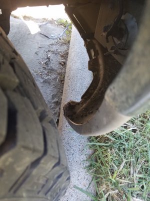

Do you have any pics of were you trim ? I might go with the same size tire in the future but don't really want to hack too much off and want to see if i like the way it looks before i go trimming How much do you trim off ?
This is all I trimmed off. It's about half an inch off of the bottom inner valence of the front right wheel well. I didn't have to do it on the left side because my valence was a little bent on the right side. You may not even have to trim if your valence and bumper isn't bent in any way. I just took a saw to it and cut it off a little. You can't even tell unless you stick your head in the fender well:
