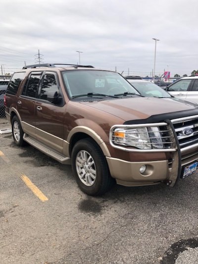

Yea not real common on the 3v engine. But to add to it I used the updated plugs (one piece Champions) the last time I changed them approx 60 miles ago. I think what happened was the vehicle has been sitting for the last 8 months and water was dripping off the cowl right onto that coil/plug. Therefore the water got down into the threads and seized it into the head. Anyway, my machine shop has had real good luck repairing this issue. Keeping my fingers crossed as I don't want to buy a head for this old vehicle. I'd rather spend the $ on the 13 I picked up for $3k that looks like its brand new. The only downfall is it may need an engine?!?
