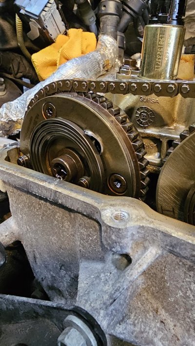

Sorry to resurrect an old thread, but I saw the recent reply and am having some issues on my job on this motor.
Mine's not on an Expedition (though a couple years ago my son and I replaced the phasers on our 2010 Expedition 5.4L - that job was much easier), but a 2018 F-150 - same 3.5L Ecoboost.
I've done the research beforehand, bought all the parts from a local dealership at fortparts.com prices. I went ahead and got all the optional seals, etc as well as all the timing components and a new thermostat / seal as well (I saw a couple videos saying that customers had come back shortly after this job was done with overheating issues and the thermostat was the reason).
I'll do a write up afterwards regarding my job, but right now I'm stuck on a particularly frustrating problem.
I can't get the old phasers off. The bolts are so torqued on there that I've already stripped out two of the bolts. The first stripped bolt, I tried a large electric impact gun followed by a large breaker bar. I figured on that one, maybe the impact gun weakened the splines in the torx bolt, so I tried just using the breaker bar. Nope, that one stripped out as well. On those two, I'll end up having to cover everything except the phasers with plastic, then grinding them off. I have a feeling the other two will end up the same. Has anyone else had this issue? In all the videos I watched, the bolts either came straight out with just a bit of resistance or the video skipped past the part of breaking the bolts free.
I'll probably just move on with the grinding, but I'm curious what others' input will be. I thought about heating them, but I'm worried about doing damage to other components in the area so I won't do that.
Thoughts?

No impact gun to be used on torque to yield bolts (similar to head bolts). You can zip it out with the impact gun after breaking the torque.
Are you sure you are using the correct torx bit?? These can be tricky since a smaller one will still fit but will lead to this damage.
Also for extracting them, not sure really what to do! Perhaps using a Dremel and many cutting disks.

I've had luck pounding a smaller socket onto a stripped bolt, maybe you could tap the next size up in there?

I'm not an expert at extracting stuck bolts, but there are plenty of people who are. Suggestions I've seen in the past include ones you've already heard here, welding a nut on the end if you are a welder and have tools, some specialty extraction devices like easy outs, or grinding the head of the bolt off so you can reduce the torque and get a hold of the bolt after removing the sprocket. The biggest enemy you have is that these are torqued really tight and some of the things that might work for low-torque applications won't work here. Grinding would make a lot of small particles in all kinds of areas where you don't want them, so a very thorough cleaning would be needed if you did that. Using some heat might help whatever route you take. I figure a machine shop can get them out in short order, and a flatbed tow there and back might also be a cost-effective choice that's a lot less frustrating. Sorry I'm not a lot of help, just throwing out some things that will hopefully help trigger a great idea. Others with more experience than I have may scoff at some of these--I'm okay with that. If you have someone else do it they may not preserve your current timing setup. Just be sure to get that back to where it needs to be upon reassembly.

I don’t think welding will work due to the high torque. Before trying welding or grinding, I would recommend trying a rocket socket rounded nut extractor. These will bite into the bolt head and can take some torque.
Oh, and I just realized the correct bit is not a regular TORX. I think it is a TORX plus.
