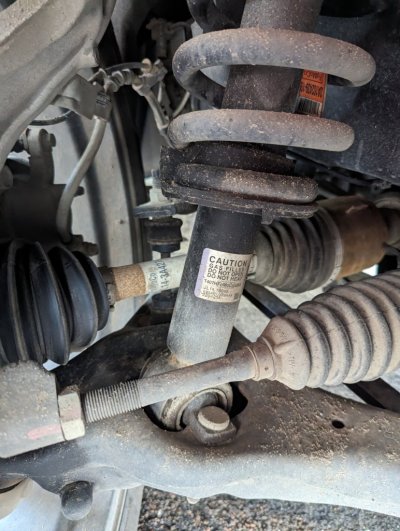

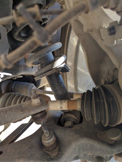

OP needs to take a closer look at his shocks. According to the 2022 order guide, the 22s on the limited he has can only come with CCD. Look at page 21 of the guide.
Front struts will look like the photos in the link below. From the outside you want see any difference to a normal strut, you’ll need to turn one of your wheels and look behind it.

Ccd is an option on limited with 22s for my22, it's not standard. From what I remember, most limited didn't have ccd unless it was ordered that way. It is more possible than not the OP had got a used limited without ccd. The only way to verify is it he can pull up his window sticker and it's in the option list.
