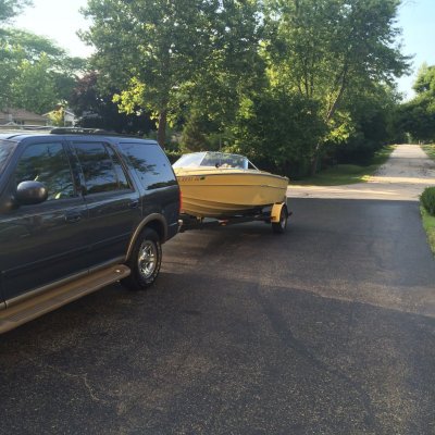

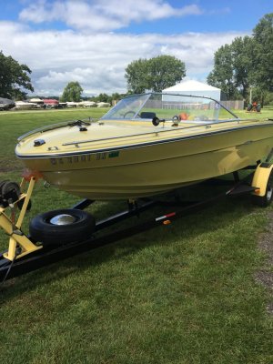

The reason for tidying up the ole gal is that I am towing my boat to Florida from Chicago early summer and I want to get everything done now so I can put miles on after the services are performed rather than getting everything done right before and hitting the road only to find out something went wrong. Ask me how I know this!
To Do List:
Already done:
All differential fluids and transfer case changed
axle seals replaced
Cat-back exhaust
Coolant ( I know)
power steering fluid flushed
brake fluid flushed
Planned:
Motor and tranny mounts
All coolant hoses, radiator and heater
Add on tranny cooler w new lines
What am I forgetting? Or is recommended?
P.S. the boat, trailer, rigged out max 3200lbs.

ok, why the Trans cooler? What gears does Expy have? If it has 3.73 it already has the tow package and larger trans cooler. How big is the boat you are towing, don't forget they are very aerodynamic, vs say a camper, alot easier to tow.
I would agree why change those hoses? I agree that you are poking the bear, and wouldn't do them. I can understand doing a new thermostat and coolant bit not the hoses
Don't understand the engine and Tranny mounts either?
