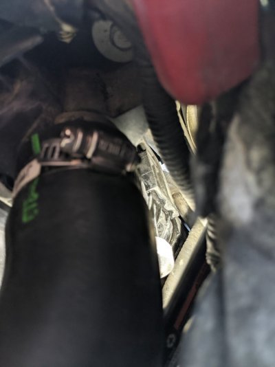

This is the best I could do. You will see the darker black below the hose and clamp that I replaced.

Maybe you can but I can't. The pic shows a black hose with green print on it. If so, the hose seems to bulge a lot after the clamp. Are you sure that you have the correct hose for the application? Have you re-tightened the clamp?
Or Double Clamp it, add another clamp above the one you already have
