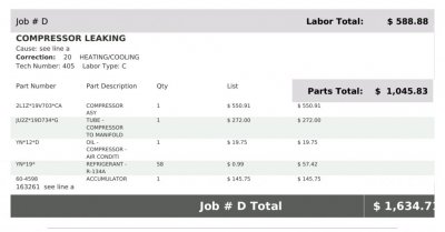

Dealership called before I was able to get back to the truck and explained the following:
The belt tensioner was "bent back" and the air-conditioning compressor pulley was damaged which also damaged the belt. To replace those items it would be a minimum of $1,426 and then they would check for additional items.
It appears the problem was a seized AC.
I have an immediate response to this but am curious if I am off base.
What say you all?

I am disappointed and reminded about why I don't trust the dealership. The invitation to authorize $1,400+ was not a solution but an interim step. I think the tensioner and belt are sub $100 parts and less than an hour of labor. That leaves $1,100+ for an AC compressor.
I just rechecked 23andMe and am reminded that my ancestry is near 99% Scotch. I'm literally genetically incapable of responding in any other way than spitting in my hands, raising the black flag and screaming freedom.
I am also wondering if I can pull the center bolt from the AC clutch and go on my way.

The seize of the AC Compressor apparently happened while parked. As a result I believe it was the energy of the starter and me trying to start the engine that caused the damage.
I can get by without the truck for now and am making arrangement for it to be towed to my home. I am interested in seeing the bent tensioner and damaged belt.

Take the belt off and see if you can spin the compressor. If you can’t, I well, they ain’t lying. If you can fix it yourself, you can start it up long enough to immediately drive on a trailer. I wouldn’t drive it anywhere though.
JollyRoger
Sep 21, 2015
94
I had something similar happen last year. AC Compressor seized, belt was shrieking (but did not bend the tensioner). Took the belt off, drove it 2 miles to a shop and had the entire AC system replaced for around $1300 I think.
