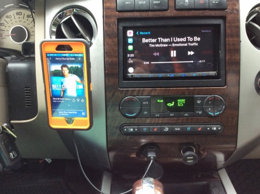

I have found out that not all double din sizes are exactly the same. In my '06, the new 2DIN stereo doesn't fit all the way in the dash opening, it is narrower than the factory one and is taller too. (the dash trim tapers in). I have to mount it "out" almost an inch to make it fit the height and add filler on the sides to make the width fit (and not have a gap). It is more than a little annoying, but It's a good thing they make kits for this.
