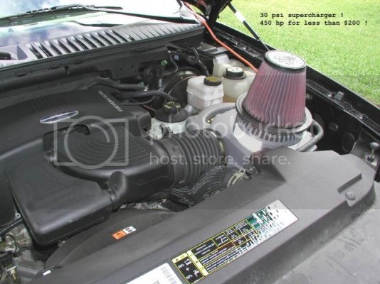

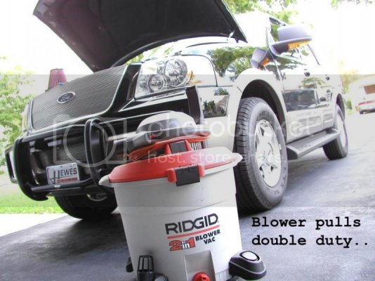

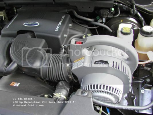

Early on in my search for more horsepower I went through many trials, and finally settled on the shop vac solution ...
Of course I needed a new air filter for my marketing photos ...
I'll have to cut a hole in the hood so I'll be able to drive with the hood closed....
I'm thinking of installing an inverter to extend my overall range....
But in the end I decided it's just a truck, not a dragster, so I returned the supercharger ....
