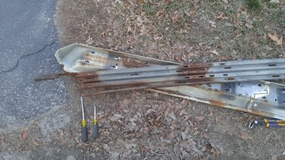

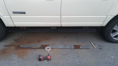

I noticed last week that my driver side running board felt spongy. Upon further inspection this is what I found. I'd recommend anyone with fixed running boards to have a look at the support because if it gets bad enough they will crack the plastic when you step on it. The part was $128 from my local Ford dealer

This is why I install mud guards! They block the salt, rocks and stones from eroding the frame or running boards.
Yeah I thought about it but not really a fan of mud flaps. Once the weather gets warm in going to pull it back off and undercoat both running board supports. Some Rhino line should do the trick

So it's just bare metal?
Wow good work Ford. Lawsuit waiting to happen much?
I can just see it: "grandma breaks neck because execs save 30 cents per unit on spray paint"
No the original is galvanized and the new is coated with something else. Looks like it's just paint though
