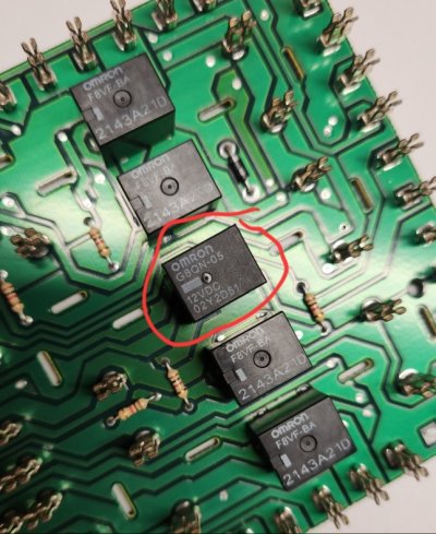

Sounds like the common Fuel Pump Relay problem (R303). Original Omron 15amp relays were not beefy enough, they overheat and melt. By 05 they figured it out and redesigned the system. My wife's '03 had the same symptoms a year or so ago - driving along with no trouble, then would just shut off. Pull over, turn key off, wait a few, then it would fire up like nothing had happened. Would do this every few days, especially on hot days. I pulled the fuse box from under the passenger dash, disassembled, removed the old Fuel Pump relay (visibly melted), and soldered a new (updated) relay in its place. Been perfect since. Make sure you get the updated relay. They are cheap and readily available on Ebay. Old relay - Omron F8VF-BA. Updated relay - Omron G8QN-05. Sometimes they can really get hot and damage the board, and the whole thing will need to be replaced. There were a number of people on ebay offering a full rebuild of the board, but a visual inspection when you pull it should tell you. It isn't that difficult of a job. Took maybe 45 mins. Search Fuel Pump Relay in this forum, you'll find LOTS of threads. Might even be one pinned at the top of the 2nd Gen page.
