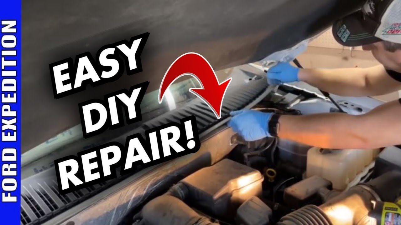

Edited to add found a picture in a YouTube video:
That's the joint the has disconnected.
Thanks to "Homeowner Repair" on YouTube:
4min 51sec mark.
